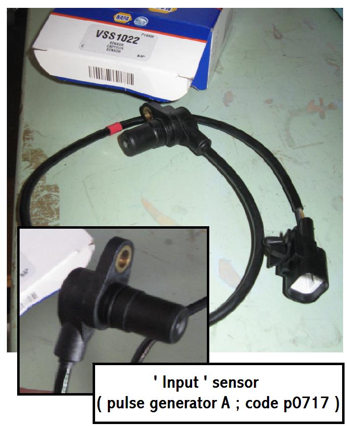

Fixed:Replaced VSS (Vehicle Speed Sensor or Variable Shaft Speed sensor or even Pulse Generator A sensor ???)
Part: NAPA part # VSS 1022 $38.00 (note: long electrical wire and connection plug attached.
Location:Hood open, face car: driver-side; front/side (not on top ) of tranny, near tire well; under battery area.
Easy to replace but had to remove several items to get to sensor: air filter box, battery & tray, front driver-side tire, small plastic cover in tire well to access sensor on tranny.

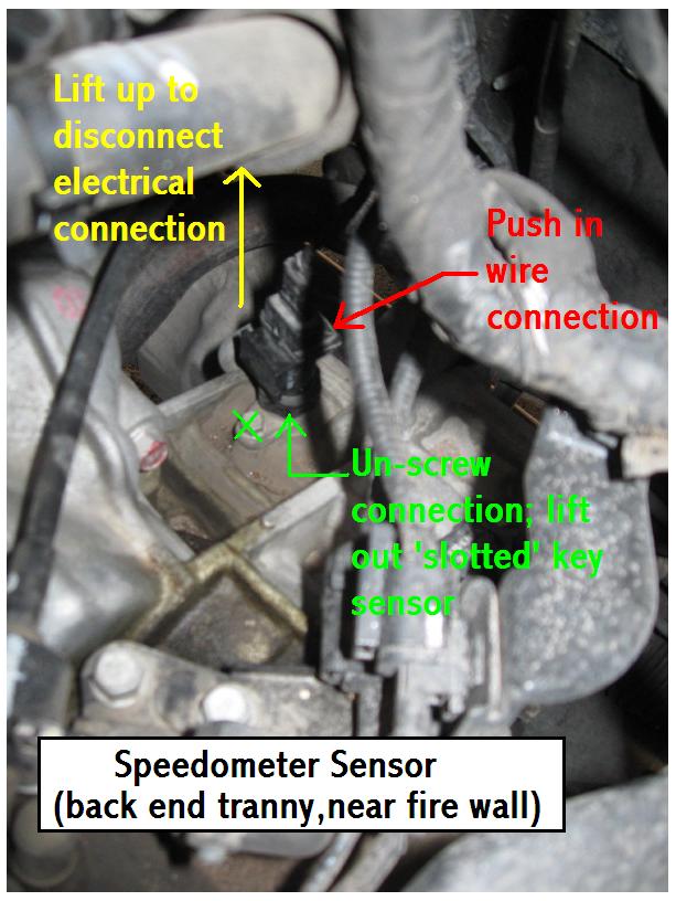

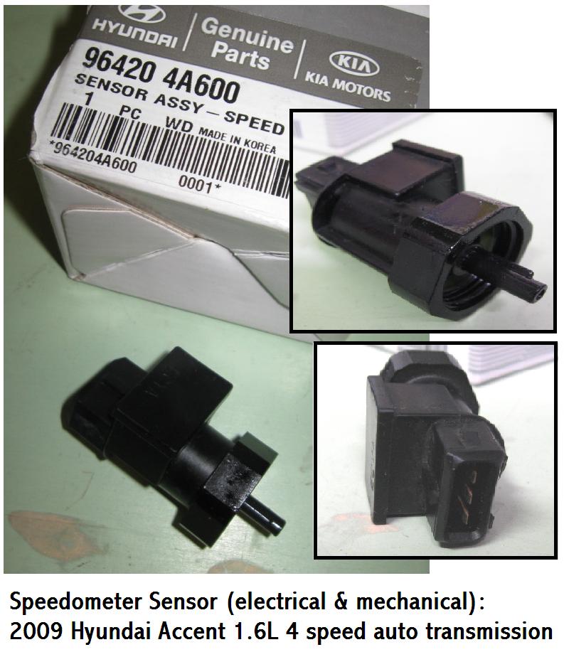

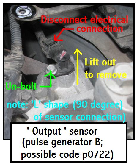

All three sensors can be 'mislabeled' as VSS sensor. But best names should be: 1) 'Input' sensor (or pulse generator A)
2) 'Output' sensor (or pulse generator B)
3) 'Speedometer' sensor (or Vehicle Speed Sensor)
Additional pics:
Attached Thumbnails P0717(related 734 & 733)-locatesensors.jpg   P0717(related 734 & 733)-inputsensoraa.jpg   P0717(related 734 & 733)-conbinationinputaaaa.jpg   P0717(related 734 & 733)-outputaacloseup.jpg   P0717(related 734 & 733)-speedometeraacloseup.jpg

Last picture:
