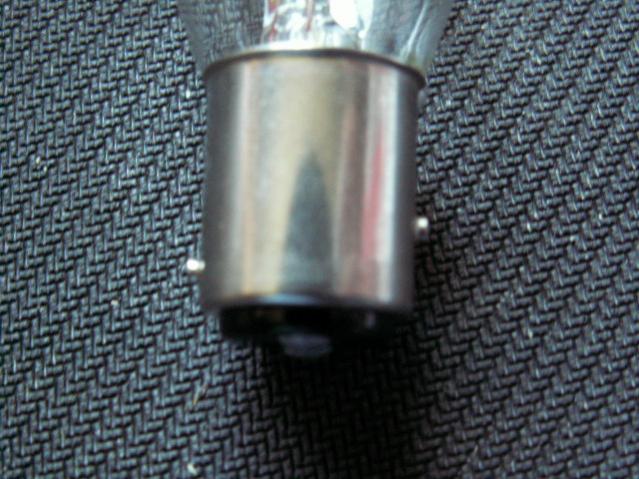

hey guys im having issues with my elantra hatchback,whats happining is the 2 main brake lights are not eluminating but the hatch light is but when my foot is not on the brakes 1 of the leds on the hatch remains eluminated.....just changed the brake switch and it is still doing it......any imput thx muchhh

Well, if the lamp on the hatch illuminated when you step on pedal, then the system has electric, and the switch was functioning... you just wasted $$ on a switch that did not need replace...
Sooo, seing the system has electric, and the switch works, lets replace the brake light bulbs on each side, as we appear to have power, but no light... lets install new bulbs as needed.
Be aware of the slots in the socket, and the pins on the base of the bulb.. this is to insure you install bulb correct so low watt filament glow when mark lights turned on, and high watt filament (brighter) glow when brake pedal pushed... ever see car go down the road with 1 bulb glowing real bright, and other glow dimmer, and when they step on pedal the low glow gets bright and no change to the other... dont be one of them people..

new bulbs installed still no power....as i was saying only 1 of the leds in the bar stays elumanated and it is constanly illumanated at all times when but when i step on the brakes all of the leds illumanate only on the back hatch still no tail light brakes......just to add all the h/l and t/l still work including the turn signals....plz help me out im only 16 and its my first car
