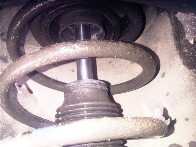

So I finally got around to bringing the car into my shop and found both front strut "dust covers" had fallen out of their retainers and were rattling around at the bottom of the spring area. All it took was a big gob of Permatex Ultra Grey and push them back up where they belong. Let the stuff set up and now just as quiet as the day we drove it home. Easy fix and I did not have to go 2 hours south for this simple repair.
Hope this helps others.

Jack up the car and check the strut boots. One on my car had fallen out of the holder it pushes into and the other all it took was to poke it and it fell out of its spot. Simple fix was the Permatex Ultra Grey at the top of the boot and shove it up into the base of the strut mount. Ours is nice and quiet now not a problem. I didn't check the rears as they are not making noise but if the design is the same I wouldn't be suprised if they have the same problems as the fronts.

Strut boots dropped
And this is hard to see unless you jack the car up or get it on a hoist. I do believe they have the ability to "stick" back up in their seat even when worn giving you the false impression they are ok. My left side was flopping around and the right side all it took was a light touch and it fell down out of the seat area. I was sceptical that this would make all the rattling noise we were hearing on the road but its been quiet ever since. Heck it cant hurt to pull them down regardless and glue them back up in there just for good measure.
