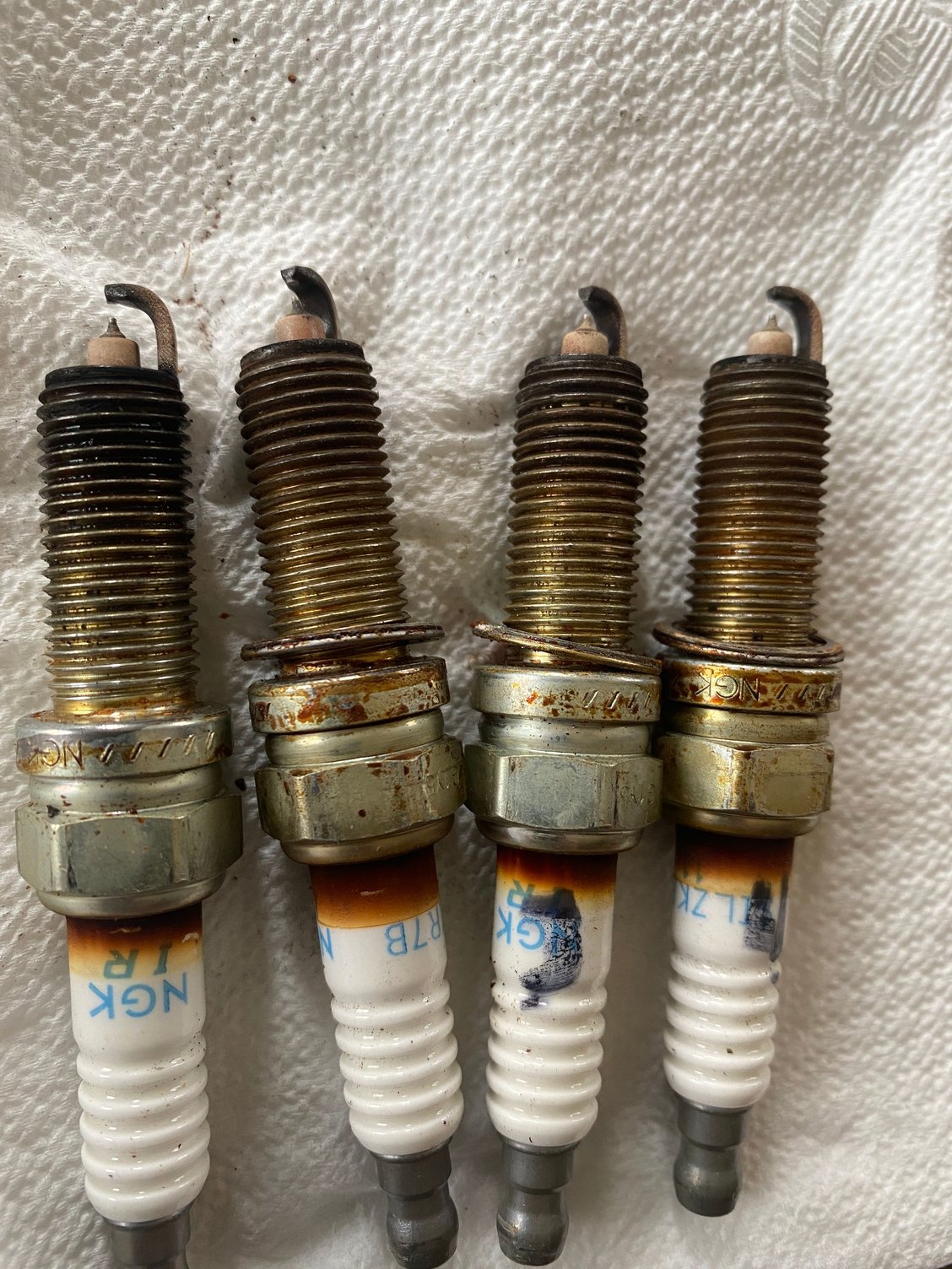

Now we have some idea of just what you mean.
Some folks call it a skip, some a miss, and some a misfire and they just about all can be caused by a brief interruption in ignition of the fuel mixture in the cyls.
When this happens the system monitoring engine performance will usually set a code in the pending section. we need to have the system checked for continuous AND pending codes.. What can you tell us as far as what kind of maintenance has been done to the vehicle.
From what you describe it could be a plug or coil breaking down under load. It will miss firing the plug or plugs, once in a while. That is felt inside the vehicle as an intermittent loss of power. Crank sensors don't always throw a code when thinking about going into retirement.
There is a function called MODE 6 that will tell us if this is occurring and which cyls are involved, but a capable scan tool is required to get this info.
It is either have some diagnostic work done or start replacing suspected parts, which can get expensive and disappointing and not recommended.
I ask about recent maintenance done because if for instance the plugs were replaced by a careless (person) one of them could have been cracked. When the spark doesn't get to the cyl as it should it finds a path to ground through the crack and does not have to happen all the time.
