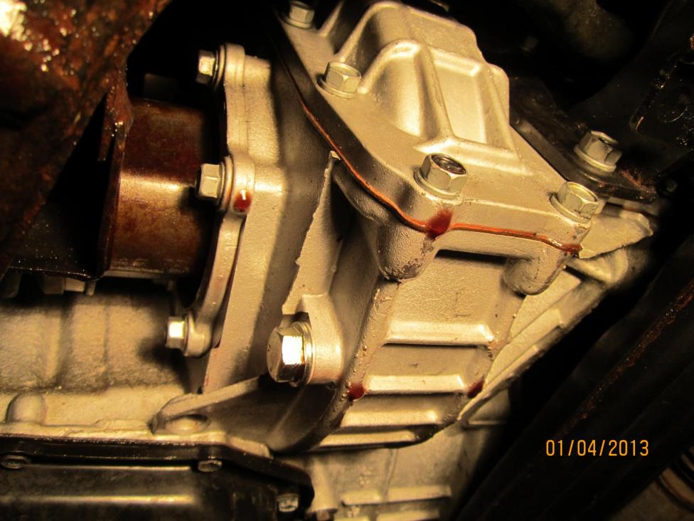

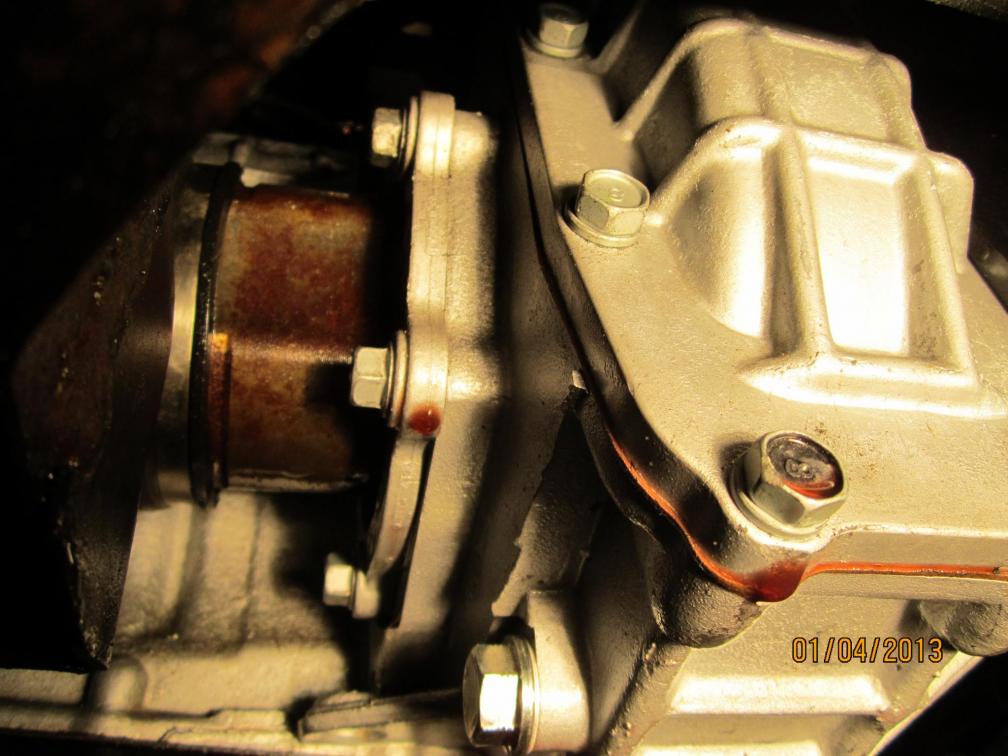

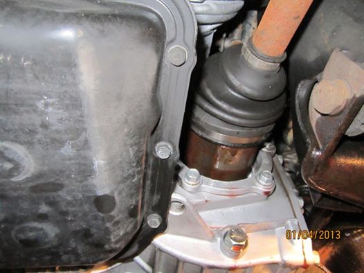

2000 Elantra. There is a leak were the axle meets the automatic transmission.
Would it be the axle or seal in the transmission? or both?
Any photo's or diagrams for the seal in the transmission would help.

The seal in the trans side. Be sure to buy oem

Drop the axle and it is the seal covering the opening into the transmission?

Yes that's correct.
