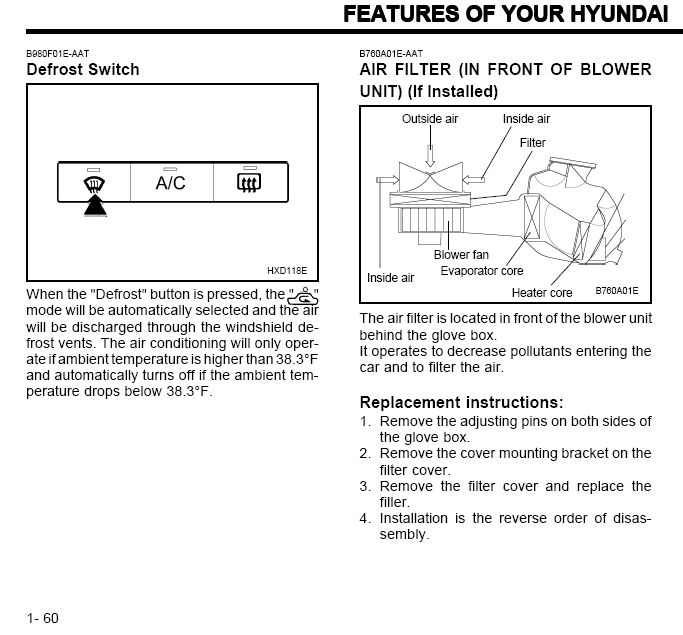

The attachment is an excerpt from the 2001 US Elantra manual. It may/may not apply to your question.
Attached Thumbnails has the Elantra ventilation filters?-01elantra_filter.jpg

You car does have the place to install one but most US cars did not come with one.
My 2004 Tiburon was the same way. So I just ordered a filter from the dealer and installed it myself.
Now, my 2006 Tucson came with one from the factory. Go figure.
