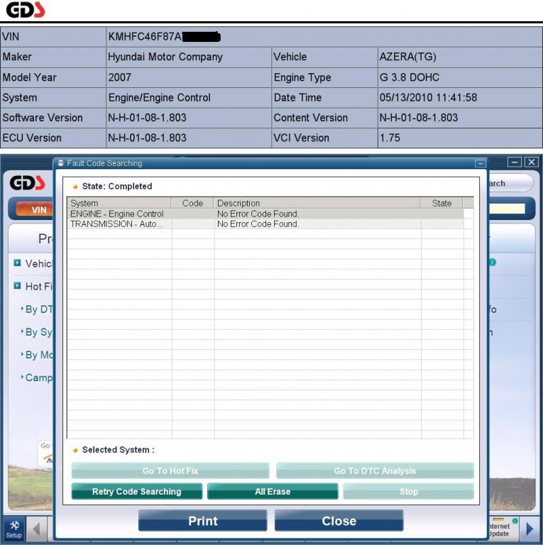

Yes...Have the modules scanned for codes, and then deal with each code as applicable..
Attached Thumbnails A/T issues 01 Elantra-pict0057.jpg   A/T issues 01 Elantra-gdssnapshot100513114158p.jpg
