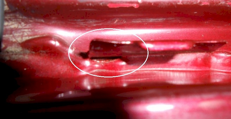

I have a bad water leak in my 2001 Elantra. I initially thought the leak was coming from the top left (driver side) corner of the windshield. I removed the plastic trim from the inside column behind windshield and found no leak there. I then lowered part of the inside roof liner and had someone run water from a hose across the roof and windshield. I observed water coming from a point above the windshield along the driver side roof molding area. (This is the molding that runs the length of the roof above the doors) Running water across this molding I found a point where the leaking starts, about 5 inches above where the molding meets the windshield. I don't know what's under that molding. (I'm assuming the molding is merely cosmetic) Is there some anchor point under the molding that may have rusted out causing the leak? Was going to just caulk around the molding on the outside but I think that's just a temporary fix. Can someone advise me as to how to safely removed the molding? I see it's about $90 for a replacement strip, I really don't want to destroy it during removal.

NovaResource - thanks for the info! I easily removed the molding. As you probably know there's a weld seam under it and some factory caulk. Found a small crack at the base of one of the tabs the clips go on, about 1/4 long and 1/32 wide. Squirted some water into it, not a big crack but lots of water came thru it into the cab. Cleaned it and filled with JB quick weld, plus some silicone on top for good measure.

Old Jul 10, 2013 | 02:09 PM
Good find. Nice job.
