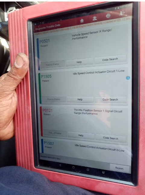

I check this issue local mechanics and no one give clear explanation for the issue. Then scan the car computer following codes shown P1505, P0121 and P1507 (refer below). They advised to replace throttle position sensor. After clearing the codes & no any codes were shown in re-scan.
Is it worth to replace the “throttle position sensor”? what is the real cause as per your perspectives.
