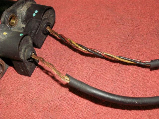

Look at the crank position for broken pigtail jacket and shorting of the 3 wires inside..

Where is the purge valve located? So the MIL light is saying there is a short in the wires?
