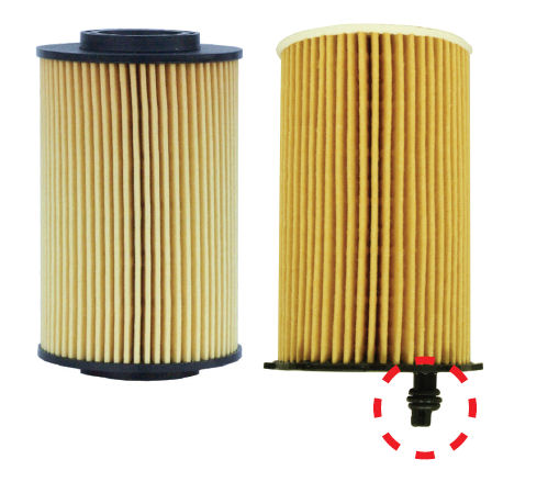

It's on the top of the engine under the plastic cover and on the driver side of the engine. Make sure you get the correct filter as there are 2 different sizes.
The canister top of the taller filter (Hyundai part #26320-3C100) looks like this:
The canister top of the shorter filter (Hyundai part #26320-3C250) looks like this:
Yours probably is the smaller filter. The taller one was used on the older cars.

Thanks, I was pretty sure I was looking at the cannister at the top left side of the engine it has a little notation that I guess indicates that it should be torqued to 35 nM - NAPA sold me what I believe to be the correct Valvolene filter, but it only came with 1 "o" ring - I may take it back and go to Hyundai - any idea on the price from Hyundai??
