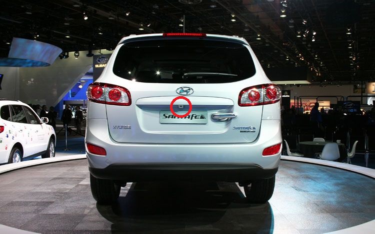

The rear camera is part of it. Look for the camera on the hatch above the license plate. It should be there. And if the grid comes up but he screen is blank then the camera is dead or the wiring is bad. If the camera isn't there then either it was removed or possibly the original non-navigation head unit was removed and replaced with the navigation unit but the person installing it didn't add the camera.
Attached Thumbnails Pre purchase equipment question-2011-hyundai-santa-fe-rear-view.jpg

Thanks, that's what I thought. I checked and there's no camera fitted, not even a hole in the tailgate trim piece where it should be, has me a bit baffled ! I'm wondering if the wiring is under there to plug a new camera in.
