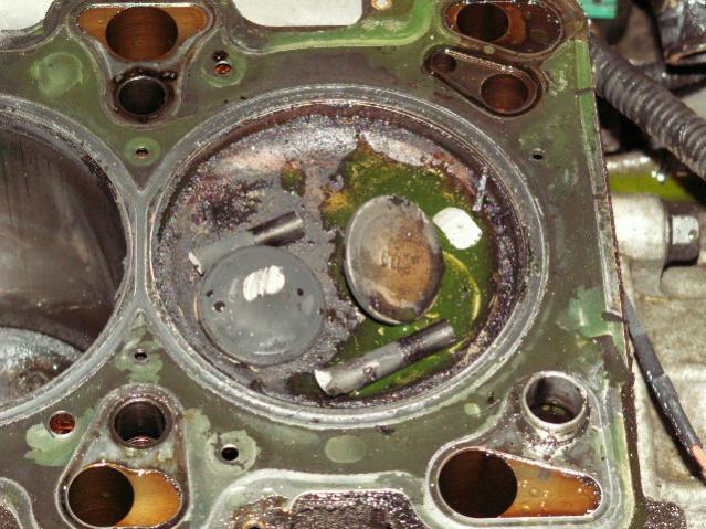

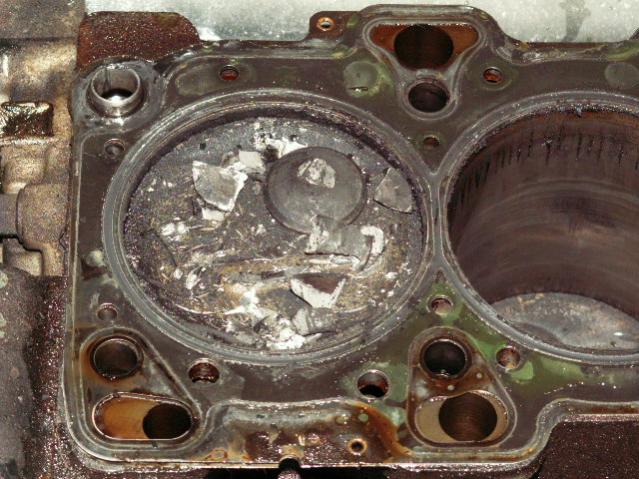

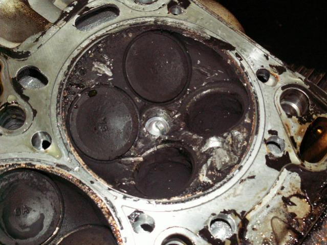

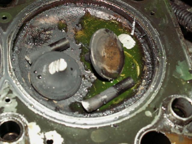

Here is a 2.4 that customer had sombody dink with, it showed up torn apart.. they told him valve guide problem.. tech a couple stalls down found the timing belt off time, and the belt was run off the exhaust cam and down, on the outside of the idler pulley with belt outside the perimeter of the belt covers. He went to turn engine by hand, and it would stop solid.. Pulled the head,......... broken parts..
Attached Thumbnails Timing belt replacement-low miles-pict0697.jpg   Timing belt replacement-low miles-pict0698.jpg   Timing belt replacement-low miles-pict0700.jpg   Timing belt replacement-low miles-pict0701.jpg   Timing belt replacement-low miles-pict0702.jpg
