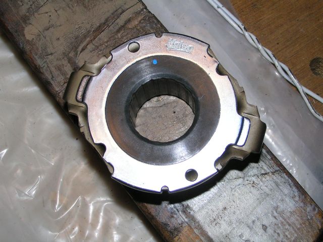

Working on a 2003 2.4L Santa Fe. In the picture of the transmission input shaft you can see a rim (red arrow) around the surface that the clutch release bearing is supposed to ride on. Is it supposed to be there? It is bigger diameter than the release bearing opening so to get the release bearing on there would take force and damage the release bearing. Do you remember seeing this when you changed your clutch?
Thanks much.

No it is not supposed to be there. Here's a pic of the new part.
This explains why I had such a problem getting the transmission out in this thread:
