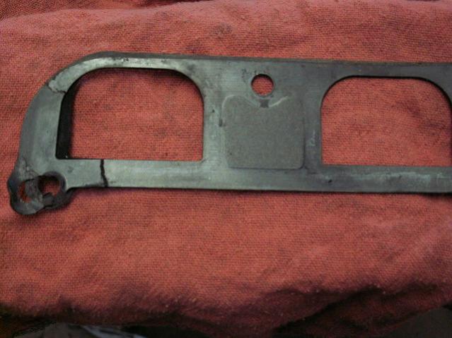

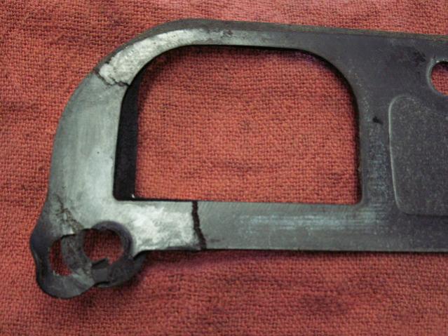

Cracked - leaking intake gasket on the 2006/2007 2.4 THETA is quite common... I just did one here recently at 83,000 I think it was..
