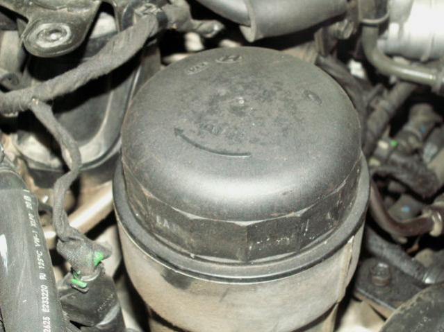

?? Never heard of this. I checked the part number on the one I got from Northstar Hyundai. It's made in Korea. Labeled as a Service kit - Oil filter part number 26320 3C100. The parts I ordered were exactly the same as this, and are supposedly the same for Santa Fe, Sonata, Veracruz with the 3.3
Early versions of the 3.3 use the -3C100 filter kit. Newer ones use the -3C250 filter, which is shorter than the -3C100 filter. See:
http://dcs.hyundaidealer.com/files/r...il_filters.pdf
for production dates. Otherwise simply look at the filter cap. Smooth is old style, molded hex nut uses the new kit.

And the document is wrong anyway.. quiet joke in training when instructor went and printed it and gave it to us..
Just look at the cap on the filter canister..
3C100 -
