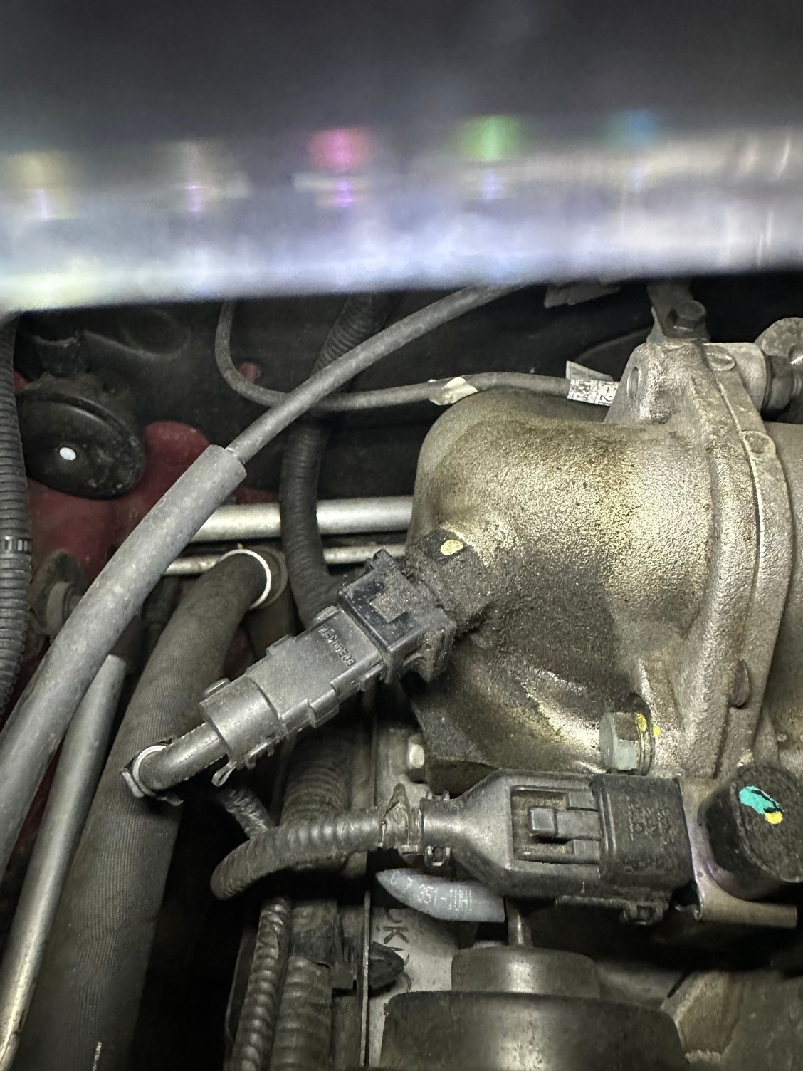

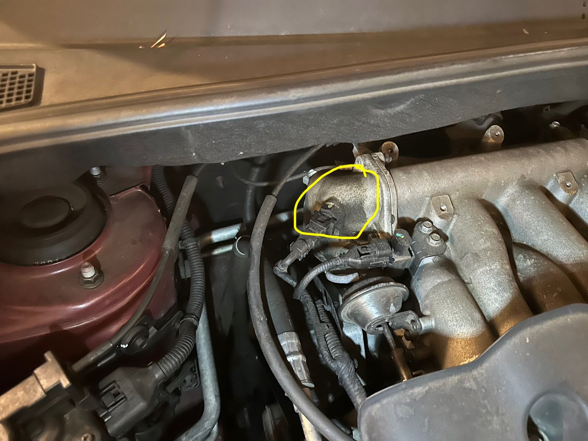

No thats ok, it was me not mentioning the exact type of vehicle. I have one more question see the greas/oil on the uploaded picture. Is that something that can be done without going to mechanic or have to take it to mechanic to replace the pipe or hose or the nut or seal? Any suggestions

This could be a minor oil or grease leak due to a loose connection, a worn-out seal, or a damaged hose. First, try tightening all connections and inspecting the hose for any cracks or wear. Clean the area around the leak to determine if it continues. If the leak is minor and you're confident in your abilities, you might be able to replace the hose or seal yourself. However, if the issue persists or you're unsure about the cause, it's best to consult a mechanic.

Not sure if this is helpful, but when i had a similar issue, it turned out to be a cracked hose. Might be worth giving everything a good once-over if you decide to DIY it.

Thank you both for the reply. I did clean up the other day i will watch and see closely
