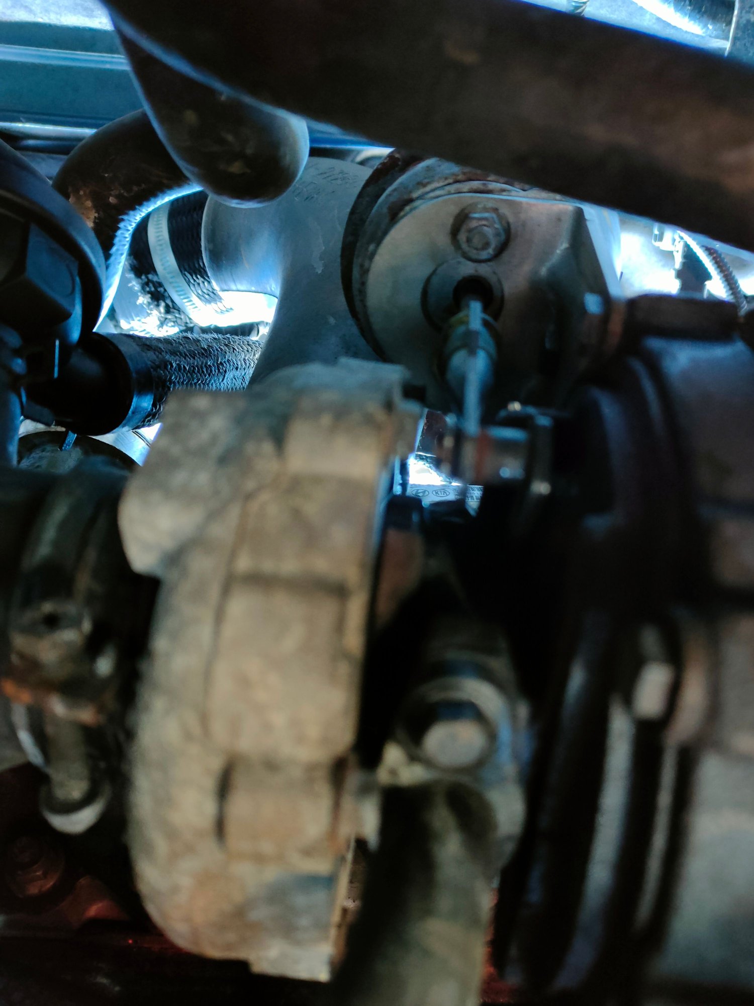

Did you look at the turbo for a sticking open wastegate?
​​​​​​Not sure if this is normal, but with the engine off or idle I am able to push the wastegate rod all the way up. So it is initially down. Should it move more freely maybe? To push it all the way up I used a wrench, cannot do it with the fingers only.
My other reply is not visible, so here it is again. The wastegate rod is initially down, I can push it all the way up (engine off or idle), although to do it I must use a wrench or some hard object. Cannot be done by hand, no space and no strong fingers

Here it is
