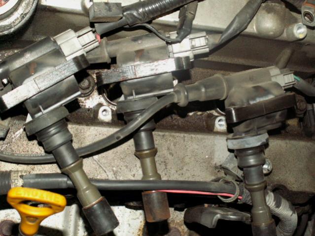

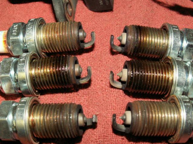

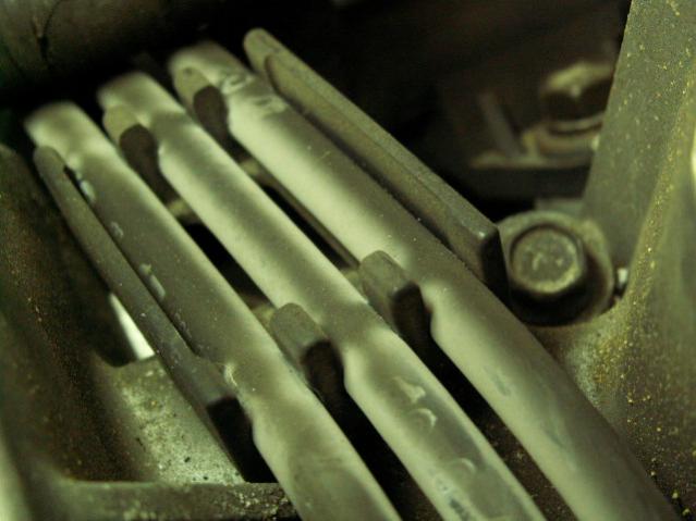

I would be more concerned about the last time it has has plugs and wires.. V6 has bad habit of burning the tar out of the electrodes on 1 bank down to the porcelin, thus it is hard to fire those offending plugs.. then the voltage needed starts looking for another path to ground.. are the plug wires covered in a white haze/dust looking ?
How about big old white spots on coil bodies (burn through)
Common Hyundai V6 trait -- burn 1 bank to porcelin, other bank looks good
Upgrade to NGK IRIDIUM, and the plugs should last longer/wear better..
As to the fuel filter, if there was problem there, it would source lean condition if filter restricting, and the fuel filter is located in the fuel pump module in the fuel tank.
