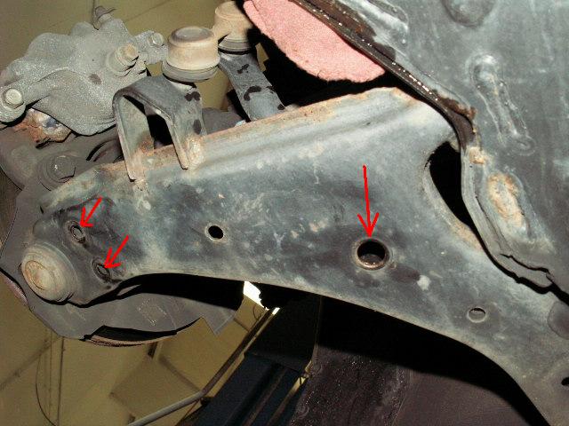

Don't drive it until it is fixed. My son was driving his 2003 elantra 55 mph down the hwy on Friday, Sep. 17, and the control arm broke. He came to a screeching halt and was able to safely stop the car on the side of the rode. Skid marks 30 ft long. When he got out, the right front tire was sideways! If anyone had been behind him, it would have been a terrible accident. Our mechanic is coming to look at it today to see if it also blew out the transmission, because it wasn't working after he stopped the car. I can't believe that anyone could make such a major part of the car so cheaply!
Good indication the arm broke
Dont bother, axle likely popped out of drive unit with the wheel going sideways.. trans will just spin..
Essentially there is nothing wrong the part, they just did not provide drain hole for water to fall out at lowest point, so arm filled up with water and rusted over time... New parts is same shape and material thickness, they just punched some holes in the stamping so it wont hold water...
Here is pic of the replacement style arm with the added holes marked with red arrow for water to drain out...
After seeing the picture that someone sent me of a control arm, I don't think that is what broke. This was a thinner piece. The guy that stopped and helped my son, said it was the A-Frame that broke. Still waiting for mechanic to come and look at it.
The picture above is of the lower control arm (AKA "A-Frame").
