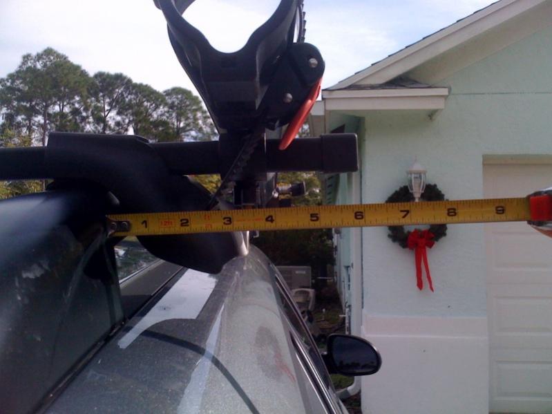

Originally Posted by lyngo
2. Those cross bars come in 50 and 58 inches. Any opinion on which would work best for the ET?
Here's a picture of my 52" Crossbars on the factory Roof Rails on a 2010 ET.
There are 6" of bar sticking outside of the Roof Rails on both sides. I hope that helps figure out which one you need. I wanted to go bigger but the next size up could hurt your head
sea kayaks side by side (I have J rax) with the 52" loadbar?
I haven't tried it but I am pretty sure I can carry two kayaks side by side on my 52" bars. There's plenty of room on the rack. I just need to get some more of those foam bumpers to do it. I'll post pictures when I get a chance to try it. On that trip, adding the bikes will not be possible since the kayaks would need the full 52" bar. I think they might stick out past the bars a bit.
Since my big kayak is pretty wide(36"), I have been able to stack one kayak on top of the other, too. We found out long ago that we were better off with a big Tandem boat instead of two smaller kayaks. I like to paddle and my girlfriend likes to sightsee. This way we stay together on the trip.
I would think with J Rax you have plenty of room since it's up on it's side. I haven't tried those yet.
