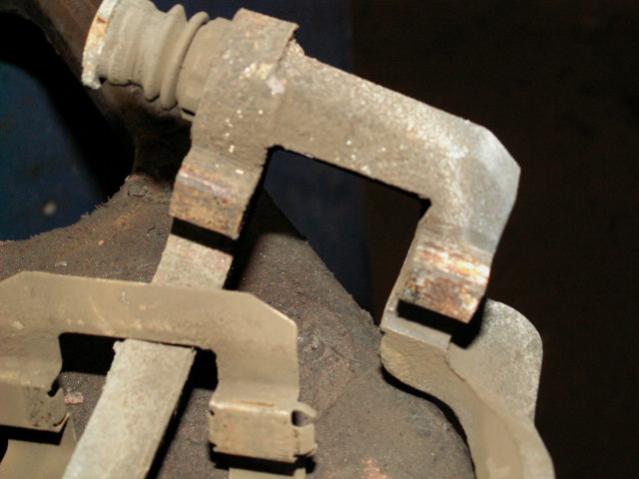

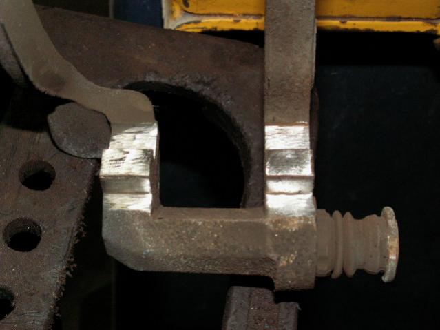

The rears only have (1) screw per side..
TIP: Using #3 Phillips driver, place blade in screw head, and whack the handle a few times to jar the screw loose, then see if it'll turn.
If you twist the head, use drill to drill head off the screw, dont get too excited about the remaining stud, use it as an align pin, or remove the stud/grind it down.
I been doing Santa Fe brakes for last 7yr on and off as customer request replacement or I upsell..
When you have the mounting bracket off, pop the shims off, grind/file the rust off to bare metal, then replace the shims.. this will allow the pads to fit into the mounts easily, and not be tight/stuck.. pull (1) slide pin out at a time, and wipe the old lube off, apply a dab of new lube, re-install pin and move it in/out of bore a few times to distibute the lube and verify pin move freely.
Attached Thumbnails 2005 Rear Disc removal-pict0048.jpg   2005 Rear Disc removal-pict0052.jpg
