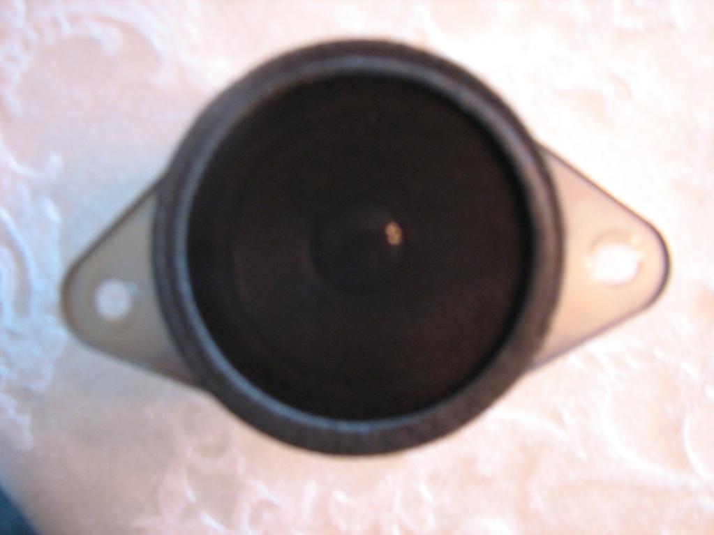

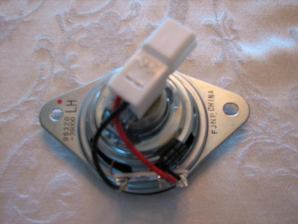

From my GLS with 6 speaker standard radio:
The crossover is a small capacitor glued to the dash speaker. I couldn't find a uF value on it so I can't say what the high pass frequency is. Regardless, this indicates the wires up to the dash speaker are providing full frequency signals.
The two mounting screws are about 3 11/16" apart. Standard spacing for a 3 1/2" speaker is 4 1/8" but many aftermarket speakers have ovaled slots so you might find one that will work. The only issue is the mounting points are not centered (e.g. 3 and 9 o'clock) but offset somewhat (e.g. 2 and 10 o'clock). This is to move the speaker away from the windshield side of the opening. You could use a small aftermarket tweeter on custom mounting plate. You might be able to use the 3 1/2" by either trimming a little bit of the dash or using one factory mounting screw and swinging the speaker a bit into available space in the dash opening.
On the underside of the grille, there is a cylinder that matches up with the speaker, approximately 2 1/2" diameter. This might need to be trimmed depending on the amount the tweeter protrudes.
Sorry about the quality of the pictures.
Attached Thumbnails 2011 Sonata GLS Stock 6-Speaker Setup-top-view.jpg   2011 Sonata GLS Stock 6-Speaker Setup-bottom-view-capacitor.jpg
