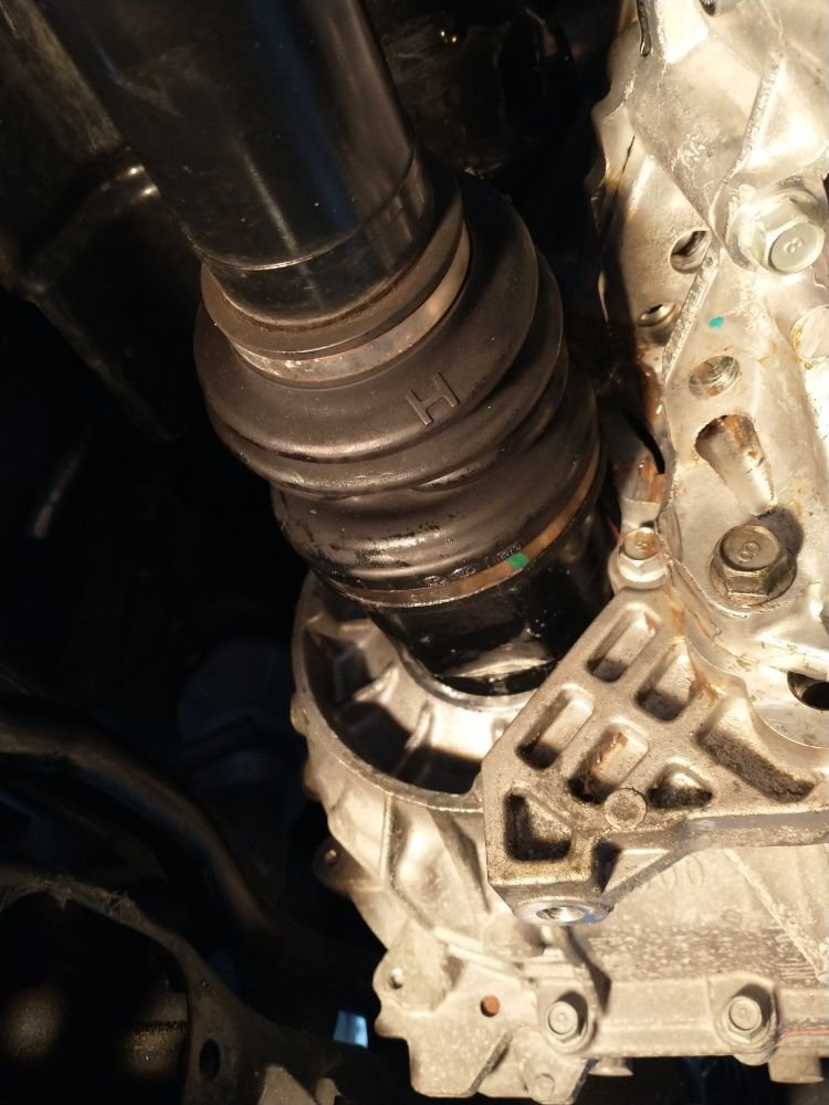

I'm replacing the RH axle in my 2016 Sonata Hybrid Limited. I watched all the YouTube videos, But I cannot get the old axle out of the transmission.
I removed the transmission "support" to get more working room around the CV joint, but there is still not a lot. The photo doesn't do it justice. The design of the transmission doesn't allow a lot of access to when the shaft enters the transmission. I don't have a CV/Axle popper fork. I hate to buy one because of the limited access. It might be a waste of money. I've sprayed it with penetrating oil. I've gotten various small bars and screwdrivers behind the CV and pushed with my foot while pulling the axle with my hands. No luck. To pry out a shaft you really want to be prying in opposite sides of the shaft, but that's not possible here.
Does anyone have any knowledge or suggestions of other things to try?

There is a retaining ring that holds the joint onto the trans. It is difficult to remove the joint without the proper tool. See if you can rent one.

Yep, I had a new axle so I knew it was the retaining ring. It really holds it in there. The 17" pry bar from Harbor Freight (The longest in the $8 set of 3) worked. Laying under the car I pushed the pry bar with my foot while I pulled on the axle with both hands. Jack stands plus tires under the car.
That retaining ring makes putting the new axle in a bit tough as well. Couldn't do that by myself. In the end I lay under the car holding the axle and making sure the splines were aligned. Held the outer CV joint straight as well. My son-in-law held a scrap 2x4 over the end of the axle and tapped it in with a 5lb hammer.
