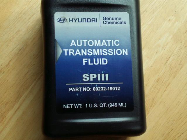

Remove the large drain plug from bottom of trans case (need 15/16 or 24mm).
Let drain, install plug (find the thin seal washer and make sure it get put back)
Add 4qt of HYUNDA/KIA 00232-19012 SP-III ATF.. let run and get real hot, inspect level with shifter in "N", add ATF slowly to bring level just to bottom of HOT zone on dipstick, test drive, verify oil level.
