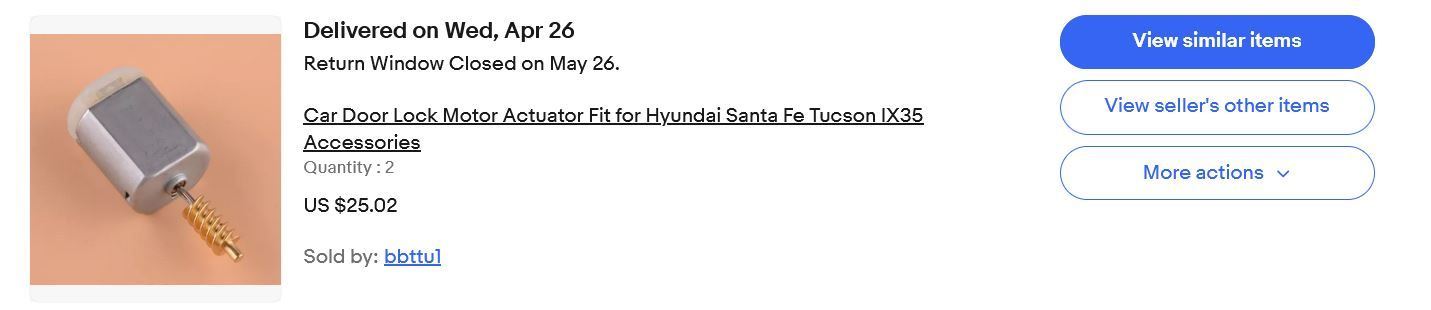

The actuators on this model are prone to failure about every 3-5 years or so in my experience. The motor's winding wear out and the motor loses strength. Some vehicles you can buy the motors and just disassemble the actuator housing and swap in the relatively inexpensive motors (say like 13 bucks for two) but on the Hyundai I have not had luck finding motors with the brass gears that match up. The motors are mabuchi FC-280pc-22125 (the "C" is for clockwise) with dimensions of ~30.5mm case length x 18mm width x 17mm diameter but the brass screw drive seems permanently affixed resulting in a need to find a direct match. Some manufacturers (ex: Ford, the brass screw slides off and is swappable to a new motor).

Here the ebay link - https://www.ebay.com/itm/28502140097...Bk9SR5TH8a7sYQ
