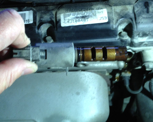

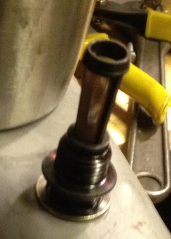

Made a check of the OCV filter and the CVVT valve, if they could be a cause of the rattle. The parts looked clean, only a few small aluminium particles in valve and filter, and some greasy black residue from old oil. Cleaned them well, and checked the operation of the valve by connection 12V to it. The valve operated faster after cleaning.
After reinstallation, the rattle was not as high as before, but I might not drive long enough and it is a bit colder weather as well that cools down the engine slightly more.
Next to check is the auto timing chain tentioner that is operated by oil pressure as well.

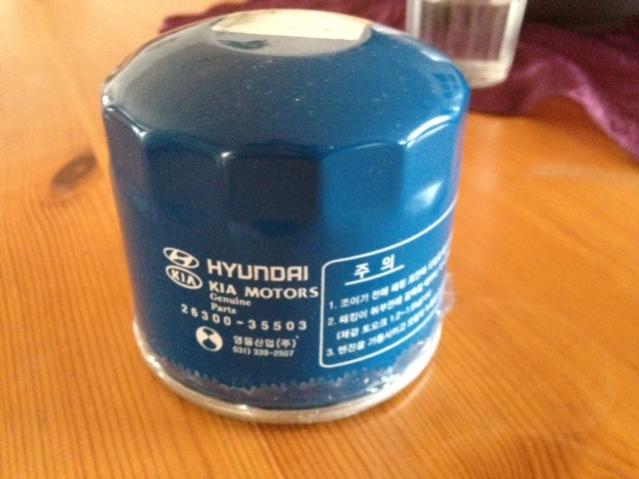

The OEM Hyundai oil filter arrived to day, only one week after I ordered it from Korea. (Korea => Norway just one week shippment)
Will fit the new filter tomorrow, and hope that fix the rattling with warm engine.

The OEM filter made a big improvement. Almost no rattle, but it can still be heard a short periot up hill and at a specific throttle pos and engine load. But now it is to live with, before it sounded as a old diesel engine.
So, the learning is, Hyundai is addicted to OEM oil filter.
