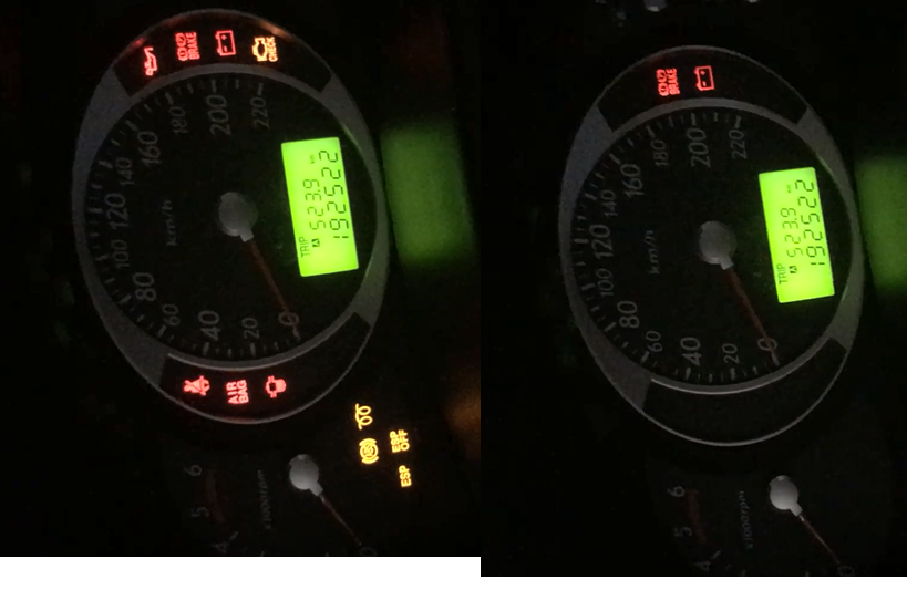

When the key is first turned to the "ON" position, do you see on the instrument cluster the alarm symbol?
Does it go out when you start to crank the engine?
If it does not then the alarm needs to be checked out.
If it does then you don't have an alarm issue.
You will need to go back to basics and check for fuel, spark, air, compression, timing, exhaust, etc

Default Can you see it?
I uploaded a picture,, the one to the left is on "ON" and the oterh is when I cranks.
