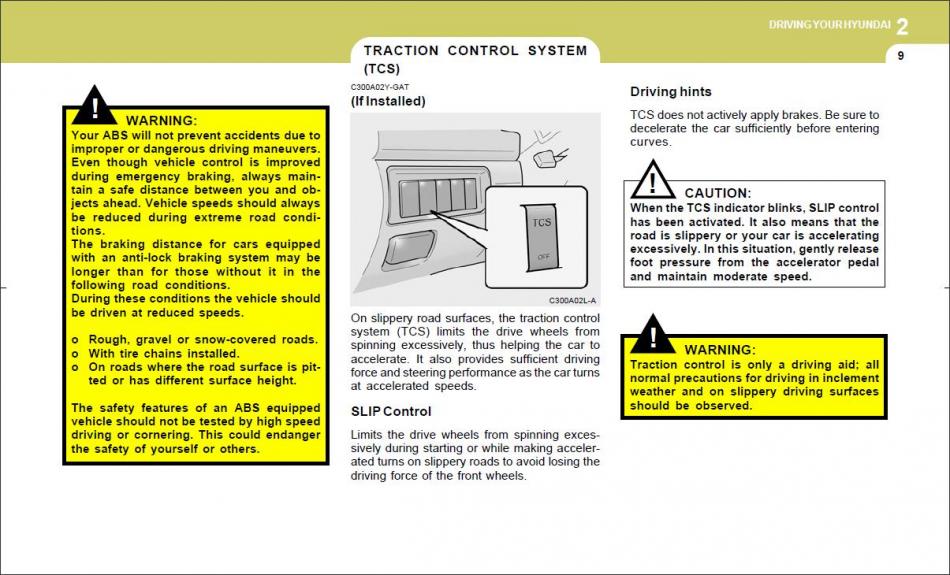

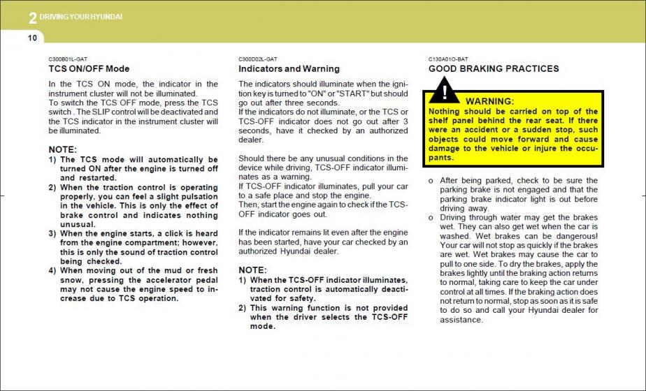

I corrected my last post. In the XG, the light just says TCS. It's newer Hyundai's that actually say TCS OFF. The switch itself does say TCS OFF but the switch does not have a light. The only light is in the instrument cluster. If the light is on then there is a problem or the system was manually turned off. The TCS light will go on for a second when the engine is started (as a test of the bulb) but will go off if the system is functioning. If the light is off and then flickers while driving, then the system detects wheel slippage and is working. If you manually turn the system off, the light will go on steady.
Do you have the owners manual? If not, I can email you a copy in PDF form.
