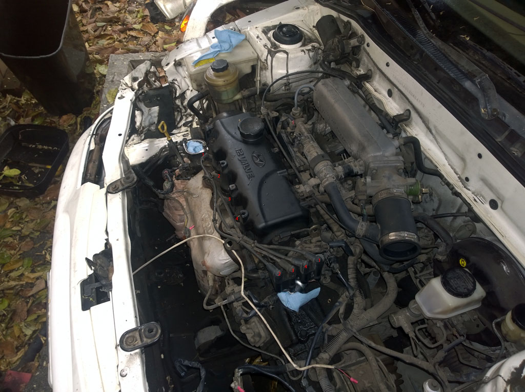

Had an issue with sputter a month ago, turned out to be a bad ignitioncable. I'm not sure I put them back in the right order...

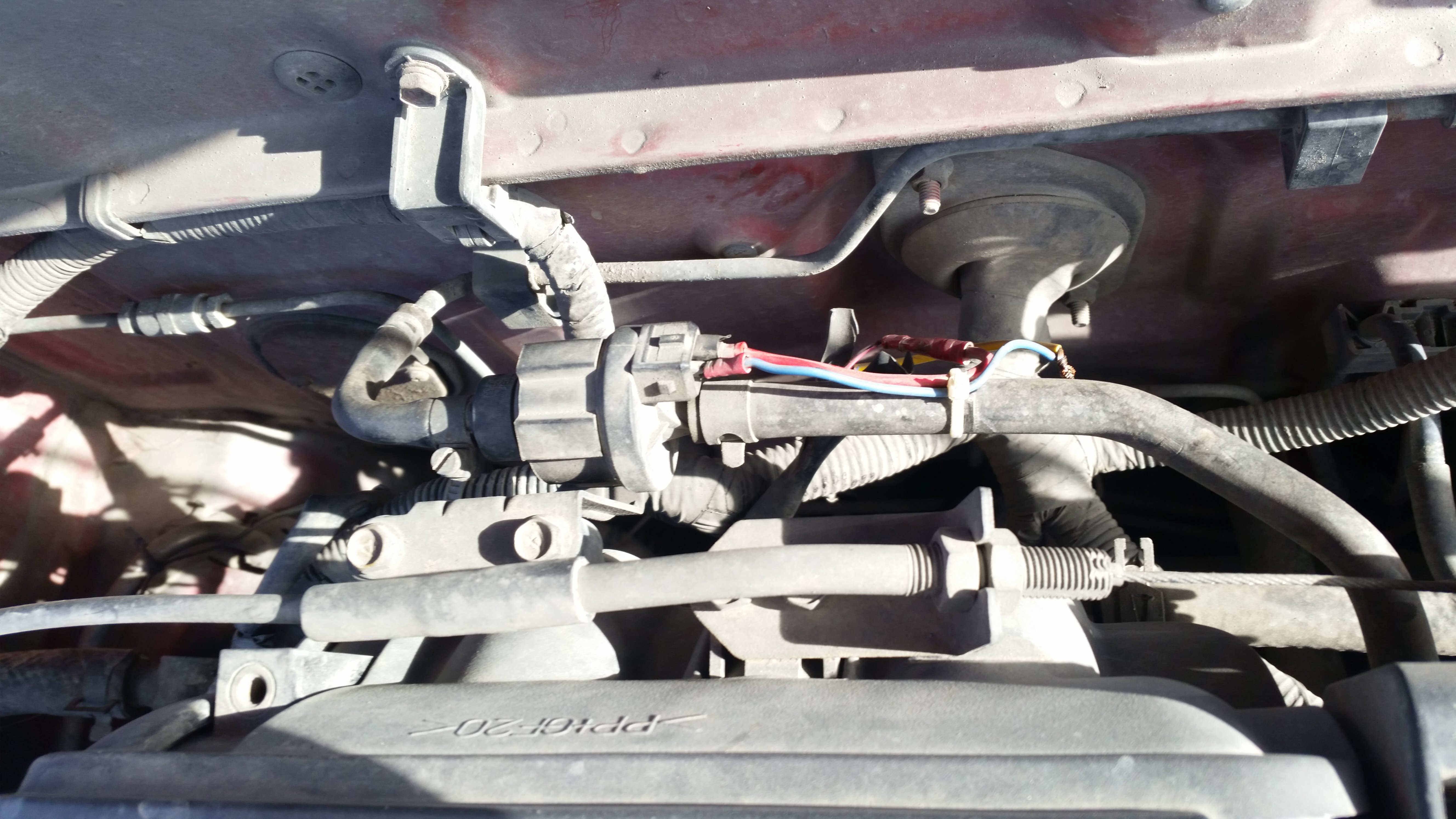

The picture is of that part. Know what it's for?

I think its evaporation system solenoid used in returning vapors from gas tank to be burned inside engine, if you take it off which is easy then you can read the part number and put # trough google it will show you what part it is exactly.
It might give you check engine code if not working however its very optional and would not affect the engine operation.
This is how ignition wires were on my car, but reference the manual to be sure google for "manual-de-despiece-hyundai-accent-98-1.5-SOHC pdf".
Thank you! I'll try to fix things and let you know how it goes.

Update. Replaced sparkplugwires. Error code gone. Car is running smooth. Made sure the evaporationthingy was plugged in correctly.
