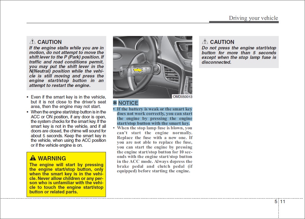

Seriously? "Killed because they could not get their car started over a 3 dollar battery?" Don't you think that's a bit over the top? If someone gets killed because their car won't start, maybe they shouldn't have been driving in the first place. Every driver is responsible for learning how the car operates. Stop blaming other people and the car manufacturer because of your own ignorance.
Last edited by NovaResource; 10-02-2015 at 08:51 AM. Reason: Added pic of owners manual page
So that highlighted part means that if the smart key is not working correctly
Then using the smart key to press on the start/stop button will start the engine
But, if the smart key isn't working then how would that work?
Wouldn't it be like pressing the start/stop button with out a smart key in the car?
I mean if there is something like a magnet in the smart key which the button can sense
Then can't someone just have a magnet to bypass the smart key?
Sorry, just curious about the operation of these start/stop buttons
Edit: So the engineers have thought about the event of key fob failure?

Warning not necessary. Here's a better idea: read the owners manual. I see lots of people complaining about perceived problems when in reality it's the owner that is unaware of how the car operates. In this case, see page 5-11 of the 2011 Elantra owners manual:
However, before I believe this, I will remove the battery from the FOB and see if this procedure works.
When my wife called me, she told me she had to use the valet key to enter the vehicle. And once in the vehicle she had no apparent power to anything including cluster lamps.
The vehicle acted as if the FOB was not there. I hope your right and using the FOB will start the car as the manual says it will.
I don't see how this would work as pushing in the start button with the FOB is any different than having it in your pocket.
There is no electrical current when the FOB battery is dead. Unless the start button recognizes the magnetic ID from the FOB? So how would touching a dead FOB to the start button make one bit of difference?
I'm asking.
I am going to try it before she gets stuck again. For the record, it was Hyundai that confirmed that a dead battery in the FOB would leave you stranded. They did not mention what you have shown in your post. And I do appreciate you doing so.
His exact word were these.
"It happened to me in my car once. I took out the FOB battery and rubbed it between my fingers. Then put it back in and it worked".
I'm asking.
I'm asking.
Today, cars are far more complicated to try to use them without reading the manual. And it's not the dealers job to train you on how to use the car. They are salesmen. The just want to sell you the car. Plus, they see dozens of models, they aren't going to know every detail of every car they sell. Great dealerships and salesman might but the average ones won't. EVERY time I've bought a car, I knew more about the car they they did.
I've never tried it as I don't own a Hyundai with push button start. I'm curious to see it work too.
Not sure, but your idea of a magnetic ID is what I believe to be the case. Also, removing the battery may not work. The manual says "if the battery is weak", not "dead". So this may only work when it's too weak to work correctly but still has some power. So removing the battery would simulate a dead battery, not a weak one. Again, I don't know if that's the case or not. Try and let us know.

However, knowing this will be useful in the future and this symptom will indicate the FOB needs a new battery.
Not the best way to find out though.
