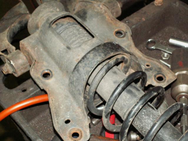

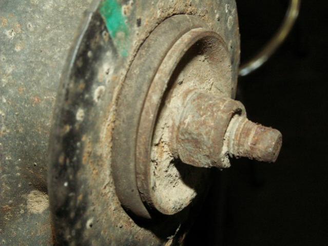

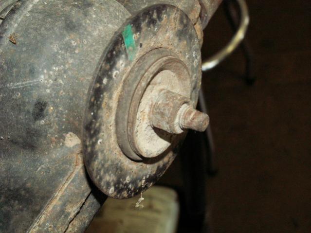

Seems to me I jsut answereed this someplace else...
Reach into the wheel well, use finger tips to feel around the upper washer.
Original bushings were compressed foam, so if you feel foam hanging out, and washer hitting mount, .. you need to replace the upper mounting parts..
In the pictures, I have a set-up with the revised rubber bushings that been installed somewhere some time ago (rust)..
You need the upper and lower bushing, a sleeve, a nut, and another pice at the bottom, I would have to go look at MICROCAT to be sure.. parts fella should be able to help, as it is kinda common problem on old XG/Sonata..
After you replace the mounting stuff, replace the sway bar bushings at rear, firming up the suspension will bring out the slop in the sway bar mounting, and it'll knock too.
Attached Thumbnails Nagging Noise-pict0246.jpg   Nagging Noise-pict0247.jpg   Nagging Noise-pict0248.jpg
